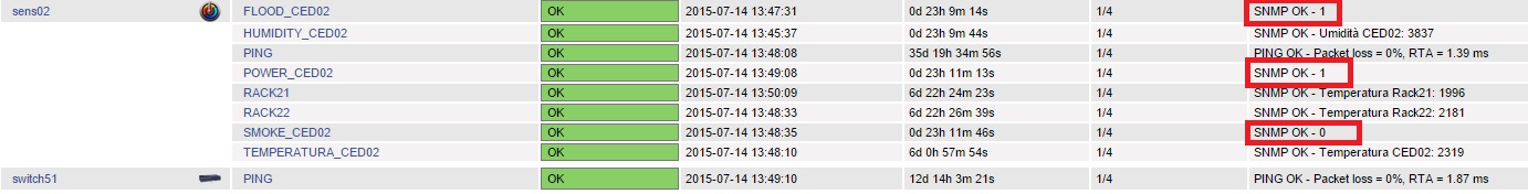

I'm here to ask you a help that is on my monitoring system Nagios, going to monitor the sensor Room Alert or a sensor that detects the temperature of the CED is of rack cabinets that the EDC itself.
So far no problems or if the temperature rises or falls depending on the set values within my /etc/nagios3/conf.d/services_nagios2.cfg system nagios I senganla through web interface and through an e-mail electronic the problem detected.
The problem occurs when I go to test the sensors:
- Flooding
- Smoke
- Power
Such sensors have as a parameter signaling of the error and the value one the value zero.
The problem is that when the state changes from one to zero or vice versa, the system should trigger the alarm but it does not succedo.
I just change the value from one to zero or vice versa on the web interface, the service label monitored stays green and does not receive any notification email.
Thank you to all who will give me advice or help to solve this problem.
Andrea

We need a bit more information.
1) What plugin are you using
2) Share with us your service definition
This is a thresholds problem, but without knowing even what command you're running it's hard for us to know if it's going to interpret thresholds properly.

Hi guys,
then the version of nagios used is the following:
root@nagios51:~# dpkg -l | grep nagios
ii nagios-images 0.8 all Collection of images and icons for the nagios system
ii nagios-plugins 1.5-3ubuntu1 all Plugins for nagios compatible monitoring systems (metapackage)
ii nagios-plugins-basic 1.5-3ubuntu1 amd64 Plugins for nagios compatible monitoring systems
ii nagios-plugins-common 1.5-3ubuntu1 amd64 Common files for plugins for nagios compatible monitoring
ii nagios-plugins-standard 1.5-3ubuntu1 amd64 Plugins for nagios compatible monitoring systems
ii nagios3 3.5.1-1ubuntu1 amd64 host/service/network monitoring and management system
ii nagios3-cgi 3.5.1-1ubuntu1 amd64 cgi files for nagios3
ii nagios3-common 3.5.1-1ubuntu1 all support files for nagios3
ii nagios3-core 3.5.1-1ubuntu1 amd64 host/service/network monitoring and management system core files
While the commands used for the monitoring of the sensors of flooding, smoke, and power are the following:
command_name check_snmp_flood
command_line / usr / lib / nagios / plugins / check_snmp -P 1 -H $ HOSTNAME $ -o $ ARG1 $
command_name check_snmp_smoke
command_name check_snmp_power
While inside the /etc/nagios3/conf.d/services_nagios2.cfg I defined as follows the structure of the service / s to be monitored:
#Control Sensor Anti-Flooding
hostgroup_name flood
service_description FLOOD
check_command check_snmp_flood! .1.3.6.1.4.1.20916.1.9.1.5.1.0!
#Control Sensor Smoke
hostgroup_name smoke
service_description SMOKE
check_command check_snmp_smoke! .1.3.6.1.4.1.20916.1.9.1.6.1.0!
#Control Sensor Supply
hostgroup_name power
service_description POWER
check_command check_snmp_power! .1.3.6.1.4.1.20916.1.9.1.7.1.0!
As I reported it enough?
Meanwhile thank the help that you are giving me to solve the problem,
Andrea

Does this work if you try adding the '-c' flag to your commands?
Give the above a shot and report back. It is my understanding that adding '-c 1:' will allow for a return code of anything less than one to trigger critically.
command_line /usr/lib/nagios/plugins/check_snmp -P 1 -H $ HOSTNAME $ -o $ ARG1 $ -c 1:Re: Problema with sensor Flood, Smoke and Power
Hi guys,
first of all I wanted to thank you because, I was able to operate the monitoring service of the sensors:
Anti-flooding
Anti-smoking
Power
The changes I made to the file /etc/nagios3/commands.cfg are as follows:
command_name check_snmp_flood_ced01
command_line / usr / lib / nagios / plugins / check_snmp -P 1 -H $HOSTNAME$ -o $ARG1$ -c $ARG2$
command_name check_snmp_smoke_ced01
command_name check_snmp_power_ced01
While inside the /etc/nagios3/conf.d/services_nagios2.cfg I made the following changes:
#Control Sensor Anti-Flooding CED01
hostgroup_name flood_ced01
service_description FLOOD_CED01
check_command check_snmp_flood_ced01! .1.3.6.1.4.1.20916.1.9.1.5.1.0! 1: 1
#Control Sensor Smoke CED01
hostgroup_name smoke_ced01
service_description SMOKE_CED01
check_command check_snmp_smoke_ced01! .1.3.6.1.4.1.20916.1.9.1.6.1.0! 0: 0
#Control Sensor Power CED01
hostgroup_name power_ced01
service_description POWER_CED01
check_command check_snmp_power_ced01! .1.3.6.1.4.1.20916.1.9.1.7.1.0! 1: 1
Changes made work and give me the possibility to receive emails or when the service takes a critical state that when he returns to normal.
Do you think the following changes can be corrected so as I descrittie?
If you can put the state "Fixed" to the message?
Thanks a lot,
Andrea
