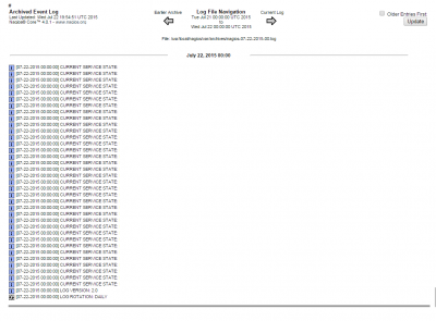

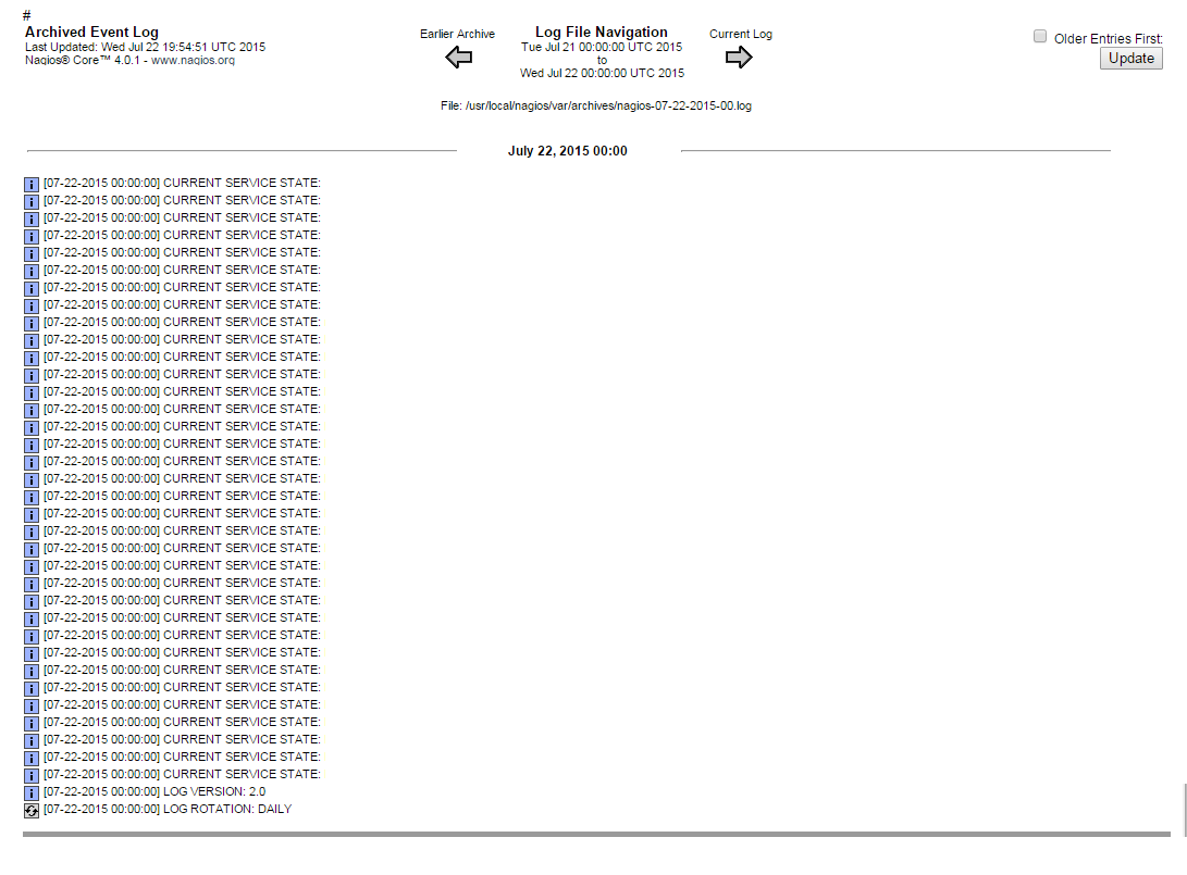

Hi Team,
We are running Nagios Core 4.0.1
The server is running in AWS to monitor other instance using snmp(not NRPE).
Previously we can find the archive log in the nagios logs and as well in event log from console.
Due to some issue we changed configuration but from that day archive logs were not storing properly. It store only with timing of 00:00:00 no data found after that. Please find configuration details of logs and i have attached the screenshot of event logs from console(Edited image).
i couldn't figured out where things gone wrong, Please assist.
some details on right were hidden,sorry i am not allowed show that.

-rw-r--r-- 1 nagios nagios  8364 Jul 16 23:59 nagios-07-17-2015-00.log
-rw-r--r-- 1 nagios nagios  8364 Jul 17 23:59 nagios-07-18-2015-00.log
-rw-r--r-- 1 nagios nagios  8364 Jul 18 23:59 nagios-07-19-2015-00.log
-rw-r--r-- 1 nagios nagios  8364 Jul 19 23:59 nagios-07-20-2015-00.log
-rw-r--r-- 1 nagios nagios  8364 Jul 20 23:59 nagios-07-21-2015-00.log
-rw-r--r-- 1 nagios nagios  8364 Jul 21 23:59 nagios-07-22-2015-00.log
-rw-r--r-- 1 nagios nagios  8364 Jul 22 23:59 nagios-07-23-2015-00.log
-rw-r--r-- 1 nagios nagios  8364 Jul 23 23:59 nagios-07-24-2015-00.log
-rw-r--r-- 1 nagios nagios  8364 Jul 24 23:59 nagios-07-25-2015-00.log
-rw-r--r-- 1 nagios nagios  8364 Jul 25 23:59 nagios-07-26-2015-00.log
-rw-r--r-- 1 nagios nagios  8366 Jul 26 23:59 nagios-07-27-2015-00.log
-rw-r--r-- 1 nagios nagios  8366 Jul 27 23:59 nagios-07-28-2015-00.log
The above are the output for archive folder.
total 13724
drwxrwxr-x 2 nagios nagios    36864 Jul 27 23:59 archives
-rw-r--r-- 1 nagios nagios   249156 Jul 28 18:59 nagios.debug
-rw-r--r-- 1 nagios nagios  1000011 Jul 28 18:59 nagios.debug.old
-rw-r--r-- 1 apache apache      303 Apr  3 14:57 nagiosgraph-cgi.log
-rw-r--r-- 1 nagios nagios    71903 Apr  3 16:39 nagiosgraph.log
-rw-r--r-- 1 nagios nagios        6 Jul 28 13:15 nagios.lock
-rw-r--r-- 1 nagios nagios    55685 Jul 28 18:15 nagios.log
-rw-r--r-- 1 nagios nagios    68166 Jul 28 13:15 objects.cache
-rw-r--r-- 1 nagios nagios    68165 Jul 28 13:15 objects.precache
-rw------- 1 nagios nagios    96220 Jul 28 18:15 retention.dat
drwxr-xr-x 7 nagios apache     4096 Apr  3 16:34 rrd
drwxrwsr-x 2 nagios nagcmd     4096 Jul 28 13:15 rw
drwxr-xr-x 3 root   root       4096 Mar  6 10:18 spool
-rw-rw-r-- 1 nagios nagios    96041 Jul 28 18:59 status.dat
-rw-r--r-- 1 root   root   12260574 May  2 06:38 test.txt
the above are the output of var directory..
Nagios.cfg
(45.42 KiB) Downloaded 443 times
Reason: Please use [code][/code] tags around long output
