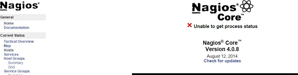

I was looking at cloning our older physical nagios server to a vm in order to free up this hardware. The clone completed fine with the vmware vcenter converter software. I do have the clone up and running and can connect to the web gui, but it shows "Unable to get process status" on that page. We are running version 4.08.

For some clarity here, could I ask you to post a screenshot of the error? There shouldn't have been complications switching over.tomtom wrote:Hello,

Re: cloning of Nagios server
What does service nagios status come back with?tomtom wrote:Sure,
Here's what it is showing in Chrome:
