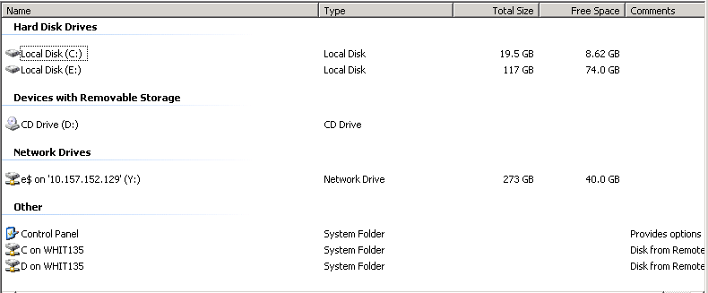

The picture 64 show the Map Network Drive.

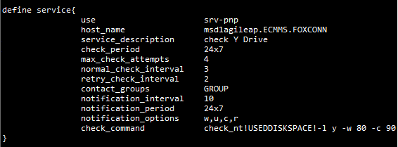

The picture 65 show the config of Map Network Drive in services.cfg.
The picture 66 show the status of the Y Drive .
So what's the problem with my configuration in services.cfg ?
How can I solve this problem to monitor the Y Drive ?

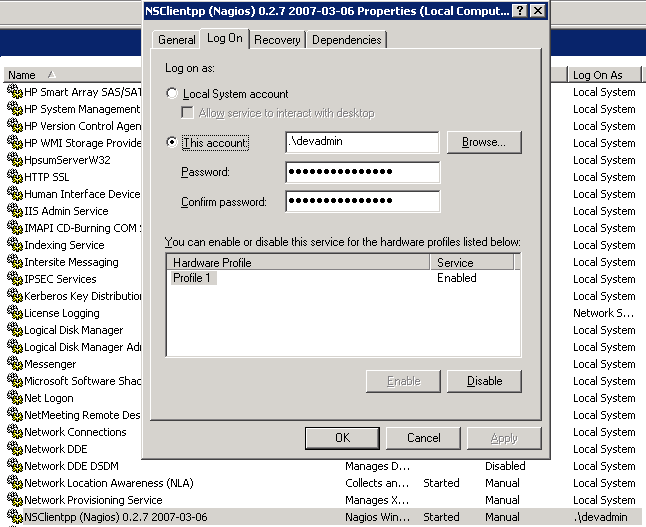

The user I log on is devadmin .
You said configure the service to run as a specific user, that may work.
Then I choose the log on as "devadmin" ,please see the picture 16.

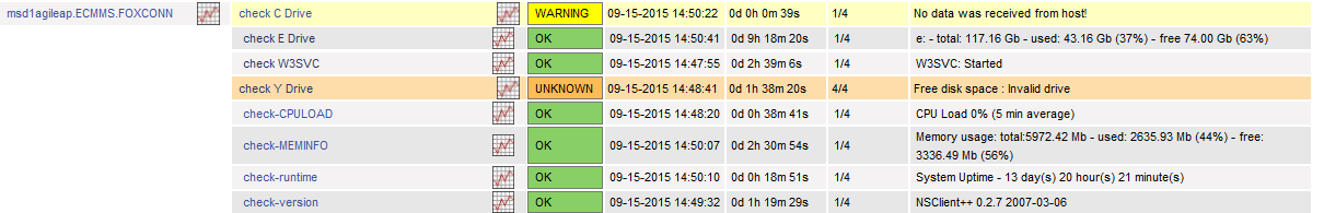

After I do this operation,the status of Y drive is continue Unknown,please see the picture 17.
