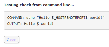

For reference, I made a command that just does echo "Hello $_HOSTREMOTEPORT$ world!" and then gave a random host the _remoteport variable with the value 1234 and ran the test command. These are my results:
2015-07-20 16_14_27-Nagios XI - Nagios Core Config Manager.png (3.79 KiB) Viewed 5390 times
Does this match up with what you are seeing? The condensing of the $_HOSTREMOTEPORT$ macro into a single $ is due to PHP failing to find a variable named $_HOSTREMOTEPORT and then reporting the remaining dollar sign as a literal.
If so, then unfortunately yes - the proper way to test is to save and let it run. There are a few known flaws with the Test Command button, and this is one of them.

Yes, the above is exactly what i am seeing, but it is OK; after three or four days of fretting about this, i have it doing what i want.
It would have speeded up this process if the "results" pop up in CCM "testing" a command string had some kind of warning about the variables in the main execution thread not being available in the "test command" (php) button (or the test somehow managed to use all available macros and variables), but i understand completely what is happening now, and thanks for your time. I guess i will have to be very careful that i do not send out lots of spurious messages when i am testing a new site or command setup.
