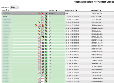

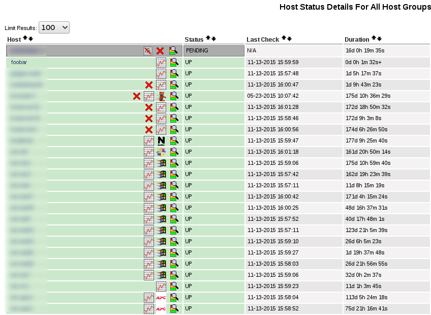

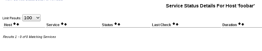

Is there a way to get Nagios to display a Host's page from the quick search function on the web mui? These are hosts without any service associated. I have many of them where all we want is the primary "ping" of the host alone as performed by the "check_keep_alive" host check. Our admins are very used to searching using the quick search box and having the properties come up for that host because I created a wildcard ping all command file in my last implementation. I am trying not to do that in my new build, but I also want to meet he expectations of all the admins who use the Nagios web interface.
I would really appreciate anyone who understands this a bit better than I do helping me clarify what has always been a source of confusion with Nagios. Thanks
Joe
Re: Hosts without a Service
At the time, there is not. I spoke with the developers about it, and added this in as a feature request.
Feel free to add any information to my request @ https://github.com/NagiosEnterprises/na ... /issues/96
As a feature request has been submitted, do you mind if I close out this thread?
