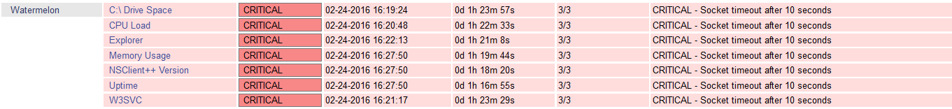

something has changed and its new now .. it shows critical timeout now... please see attached error.
no firewall ... port allowed also in firewall for TCP and UDP both .. but my bad .. ;(

Please do the following on the server you want to monitor an post the output:
netstat -an
The $HOSTADDRESS$ is a macro for the ip address of the host you want to monitor.
I'm not sure what password do you mean? Do you have a different NRPE config on each server?

how the variable of IP will get filled and where to put the password
The IP address is taken from the host your service is attached to. That is what the $HOSTADDRESS$ macro does.
Check on the remote server and post your nsclient.cfg please - I'm interested in taking a look at it. You can find this on your remote Windows machine at C:\Program Files\NSClient++. It might also be called nsclient.ini
