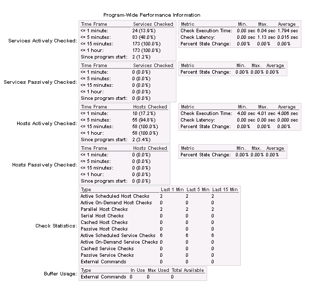

It sounds like you're hitting a throttle somewhere.
What is the output of top|head -n6?'
Can you attach a screenshot of your 'Performance Info' page?
Do the checks work if you run them from the CLI of Nagios? Can you show us the full input / output you're entering?

Hi Rkennedy, thank you for the response,
the output of top|head -n6? is
top - 13:28:13 up 10 days,  4:31,  2 users,  load average: 0.00, 0.01, 0.05
Tasks: 145 total,   1 running, 144 sleeping,   0 stopped,   0 zombie
%Cpu(s):  0.2 us,  0.1 sy,  0.0 ni, 99.7 id,  0.0 wa,  0.0 hi,  0.0 si,  0.0 st
KiB Mem :  1884388 total,   921724 free,   273152 used,   689512 buff/cache
KiB Swap:  2097148 total,  2097148 free,        0 used.  1380600 avail Mem
I have attached 2 screen shots of the Performance page.
thank you for looking
