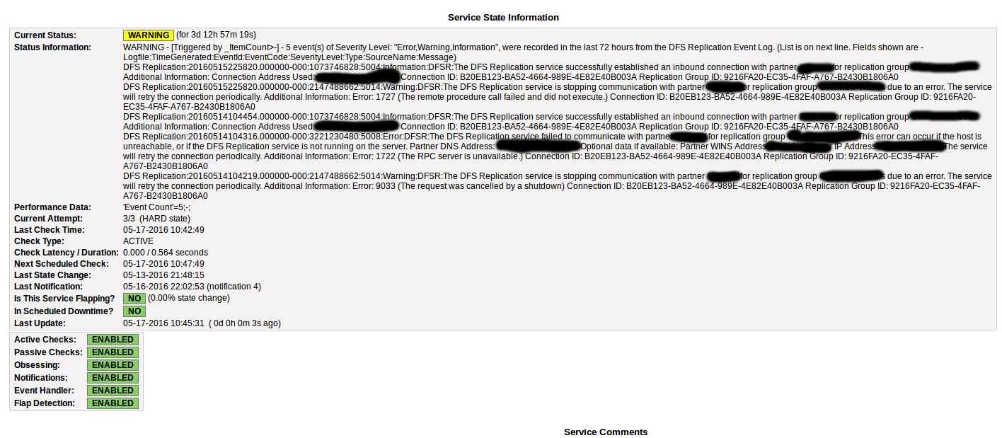

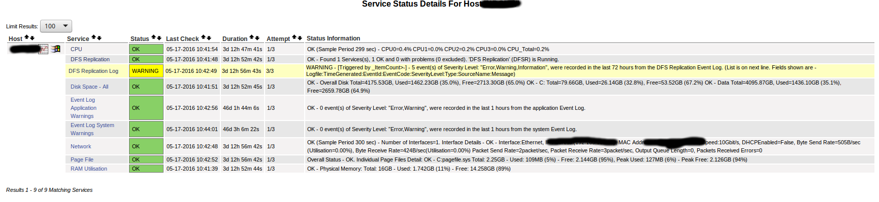

It turns out it's just the different views, it shows in one but not another - please see screenshots
Service Status Detail for HOST doesn't show everything however when I go into Service State Information everything is there.

Take a look in your /usr/local/nagios/var/status.dat file and look for the service, your first screenshot is likely putting in plugin_output AND long_plugin_output, your second screenshot is only meant to show the plugin_output because it's a summary page.

Okay that does make sense Thanks
plugin_output=WARNING - [Triggered by _ItemCount>-] - 7 event(s) of Severity Level: "Error,Warning,Information", were recorded in the last 72 hours from the DFS Replication Event Log. (List is on next line. Fields shown are - Logfile:TimeGenerated:EventId:EventCode:SeverityLevel:Type:SourceName:Message)
long_plugin_output=DFS Replication:20160518050054.000000-000:1073746828:5004:Information:DFSR:The DFS Replication service successfully established an inbound connection with partner XXXX for replication group XXXXXXXXXXXX. Additional Information: Connection Address Used: XXXXXXXXXX Connection ID: B20EB123-BA52-4664-989E-4E82E40B003A Replication Group ID: 9216FA20-EC35-4FAF-A767-B2430B1806A0\nDFS Replication:20160518045829.000000-000:2147488662:5014:Warning:DFSR:The DFS Replication service is stopping communication with partner XXXXX for replication group XXXXXXXXXX due to an error. The service will retry the connection periodically. Additional Information: Error: 1722 (The RPC server is unavailable.) Connection ID: B20EB123-BA52-4664-989E-4E82E40B003A Replication Group ID: 9216FA20-EC35-4FAF-A767-B2430B1806A0\nDFS Replication:20160518041736.000000-000:1073746828:5004:Information:DFSR:The DFS Replication service successfully established an inbound connection with partner XXXXXX for replication group XXXXXXXXXXXXXXXXXXXXX. Additional Information: Connection Address Used: XXXXXXXXXXXXXXXXXX Connection ID: B20EB123-BA52-4664-989E-4E82E40B003A Replication Group ID: 9216FA20-EC35-4FAF-A767-B2430B1806A0\nDFS Replication:20160518041716.000000-000:3221230480:5008:Error:DFSR:The DFS Replication service failed to communicate with partner XXXXXXX for replication group XXXXXXXXXXXXXXXXXXX. This error can occur if the host is unreachable, or if the DFS Replication service is not running on the server. Partner DNS Address: XXXXXXXXXXXXXXXXXXXXXXXXXXXX Optional data if available: Partner WINS Address: XXXXXXXXXX Partner IP Address: XXXXXXXXXXXXXXXXXXXX The service will retry the connection periodically. Additional Information: Error: 1722 (The RPC server is unavailable.) Connection ID: B20EB123-BA52-4664-989E-4E82E40B003A Replication Group ID: 9216FA20-EC35-4FAF-A767-B2430B1806A0\nDFS Replication:20160518041428.000000-000:2147488662:5014:Warning:DFSR:The DFS Replication service is stopping communication with partner XXXXXX for replication group XXXXXXXXXXXX due to an error. The service will retry the connection periodically. Additional Information: Error: 1722 (The RPC server is unavailable.) Connection ID: B20EB123-BA52-4664-989E-4E82E40B003A Replication Group ID: 9216FA20-EC35-4FAF-A767-B2430B1806A0\nDFS Replication:20160515225820.000000-000:1073746828:5004:Information:DFSR:The DFS Replication service successfully established an inbound connection with partner XXXXXXX for replication group XXXXXXXXXXXXXXXX. Additional Information: Connection Address Used: XXXXXXXXXXXXX Connection ID: B20EB123-BA52-4664-989E-4E82E40B003A Replication Group ID: 9216FA20-EC35-4FAF-A767-B2430B1806A0\nDFS Replication:20160515225820.000000-000:2147488662:5014:Warning:DFSR:The DFS Replication service is stopping communication with partner XXXXXXX for replication group XXXXXXXXXXXX due to an error. The service will retry the connection periodically. Additional Information: Error: 1727 (The remote procedure call failed and did not execute.) Connection ID: B20EB123-BA52-4664-989E-4E82E40B003A Replication Group ID: 9216FA20-EC35-4FAF-A767-B2430B1806A0Re: Status Information Length
