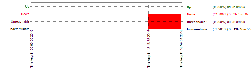

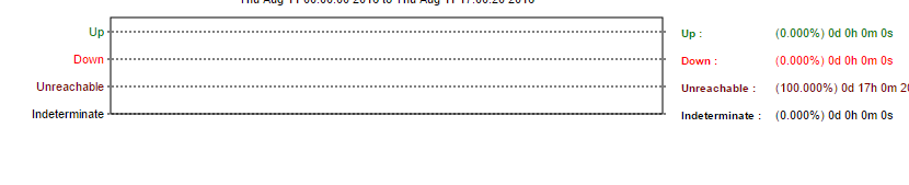

Good afternoon!
I am looking to implement a Nagios Core server to help the business I work for and all looks good so far!
I have run into a strange issue, where the Nagios server is recording down time but not uptime? (probably a simple fix but I'm newbie on linux!)
Second, most of our customers have numerous servers behind external NAT IP addresses, is there a simple solution to being able to monitor these? I did think of a site to site VPN to them however due to them having similar subnets this will cause issues.
Many Thanks in advance for any help :).
Cheers,
Steve
Nagios UP.PNG (7.75 KiB) Viewed 2316 times
Nagios Fail.PNG (11.22 KiB) Viewed 2316 times

Is your service currently in an UP state, or is it in a down / unreachable state as noted by the screenshots?

I have used one host to test the down which is in the one print screen, the other was the local host which is definitely up :).
Re: Trends issue and a general question!
Can you post the Standard settings and the Advanced settings you used when running the trends in your examples?
