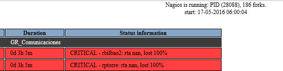

The problem is when we restarted these services dialy all things via "Nagios Web" are cleaned. The hosts and services that last day were attended, after "restart" are without attend, the "accounting" of "Duration" field show time since last restart. This is wrong. We have a lot problems with hosts or services since a lot days or months, but dialy we have attend again because this problem.
For example, now are 09:05
the last restart was at 06:00 and all things show "Duration" 0d 03h 5m without attend, but yestarday before 06:00 we attended it.

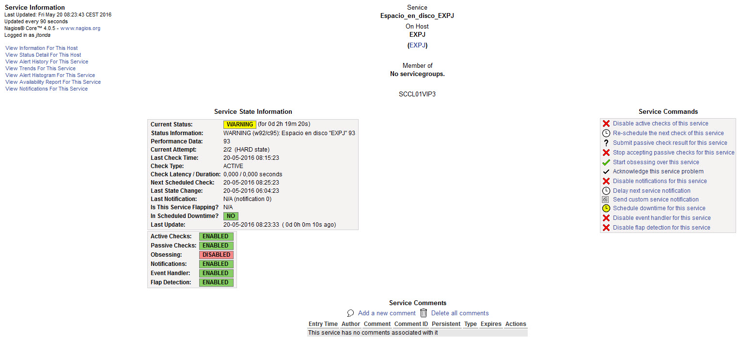

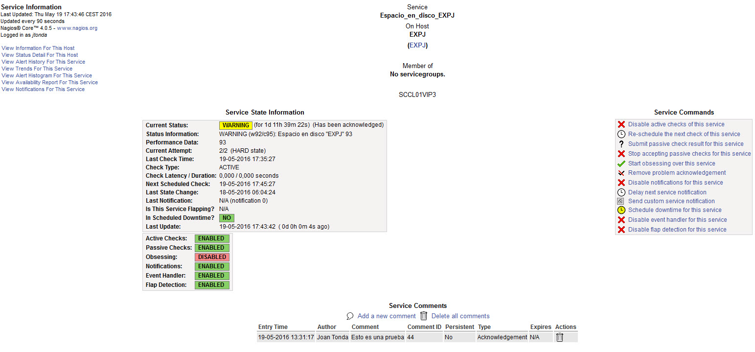

This is a services with "acknowledge problem" yesterday at 5:35pm
and this is the same services today at 8:15am after restart Nagios service daily at 6:00am
