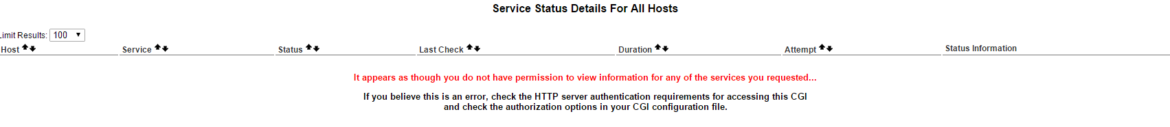

Postby awan » Thu Sep 22, 2016 2:23 am
It appears as though you do not have permission to view information for any of the services you requested...
see the attach

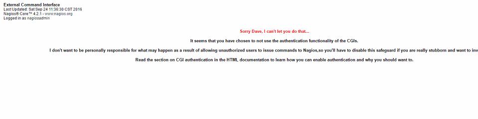

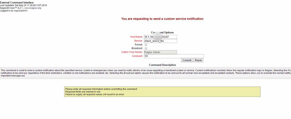

Postby awan » Fri Sep 23, 2016 10:42 pm
os:radhat 6.8
nagios:4.2.1
and i make a cron to keep the /usr/local/nagios/var/rw/* files have the 777 privileges as following:
1 * * * * chmod 777 /usr/local/nagios/var/rw/*
when I fresh the web,somethings the error will occurs!
and now i do this operation:
and then error occurs ;
so ,I am so worry about the newest version ..

Postby rkennedy » Mon Sep 26, 2016 11:10 am
Usually permissions have to do with how it was initially compiled. What guide did you follow when installing Nagios? It might be better to start fresh and recompile from the start.
This document should work and is one of our offical ones - https://assets.nagios.com/downloads/nag ... Source.pdf
