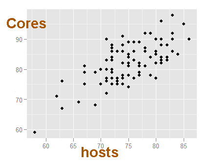

Probably we could collect data from many users, therefore from many different environments, and create a graph like that:
Then we could have a good idea what is happening in real world
Re: Hardware Requirements for running Nagios 4.2.1
That would be nice, but it would require that people volunteer that data. And even with that, strictly going off the number of hosts is not going to be accurate across all installs due to the many variables at play. As I said before, if you can provide some details we can help scope it out, but there is not a great forumla that can be applied to all environments.
