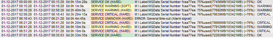

Hello all,
I am using Nagios 4.1.1.
When I create an "Availability" report for the service for the last 24 hours, the "Service Log Entries" appearing refer to a wrong time period.
For example:
Report period today: Today --> 8/1 up to 12/1
Report period today: Last 24h --> 7/1 up to 12/1
Report period today: Yesterday --> 7/1 up to 12/1
The rest options seems to work as expected.

Re: Strange availabilty report
When the Availability report is run, there is a setting called "Backtracked Archives (To Scan For Initial States):" and that is set to 4 to go back 4 days to determine the initial states.
When the report is displayed, it will show them on the report. If you set that to 0, they will not be displayed on the report.
Try doing that and see if it displays the expected results you are looking for in your report.
