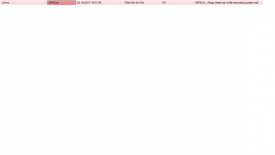

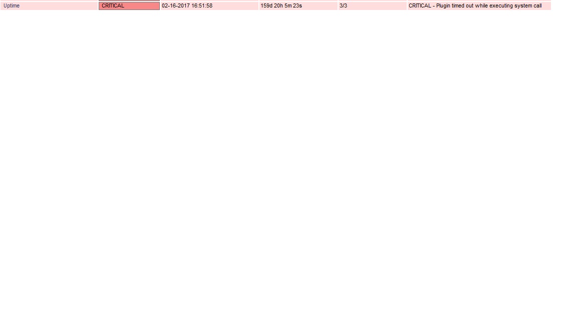

I am using Nagios® Core™ Version 4.2.1 on cent OS 6.5. I am monitoring router/server ping and uptime.
When i see the dashbaord in host/services ping is working fine but uptime is not working giving error " CRITICAL - Plugin timed out while executing system call "
I have checked net-snmp rpm on cent os and it is installed. Please support how to do that (please find the attached error snapshot)
but when i am trying to do snmpget -v1 -cpublic 172.16.0.216 iso.3.6.1.2.1.1.3.0
I am getting
Timeout: No Response from 172.16.0.216.

Oops, there was wrong setting on Cisco switch for SNMP.
After correcting this it is working fine...thnks for the help
