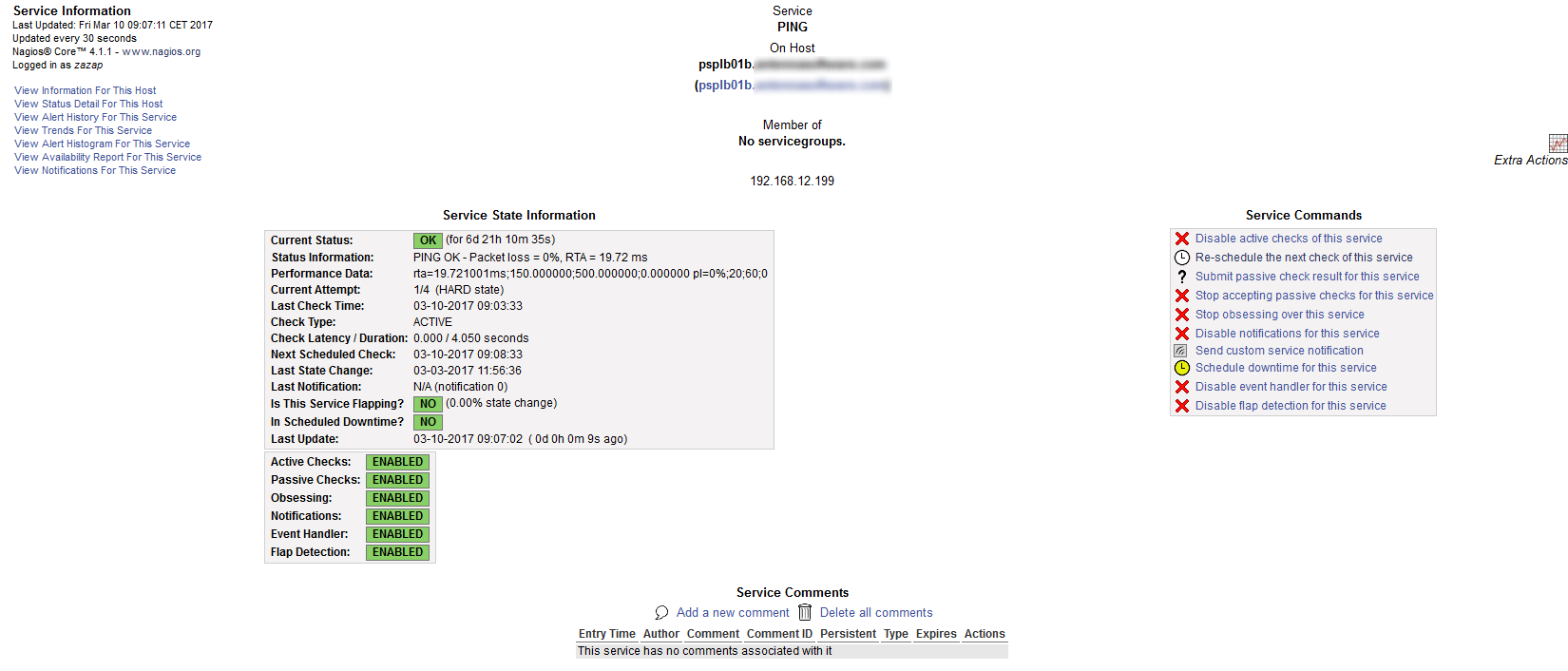

Just for sake of make things clear - here is a screen for the service with current performance data.
PZ
