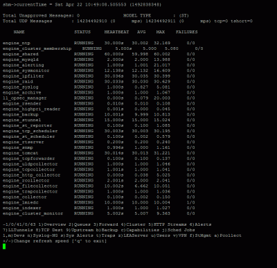

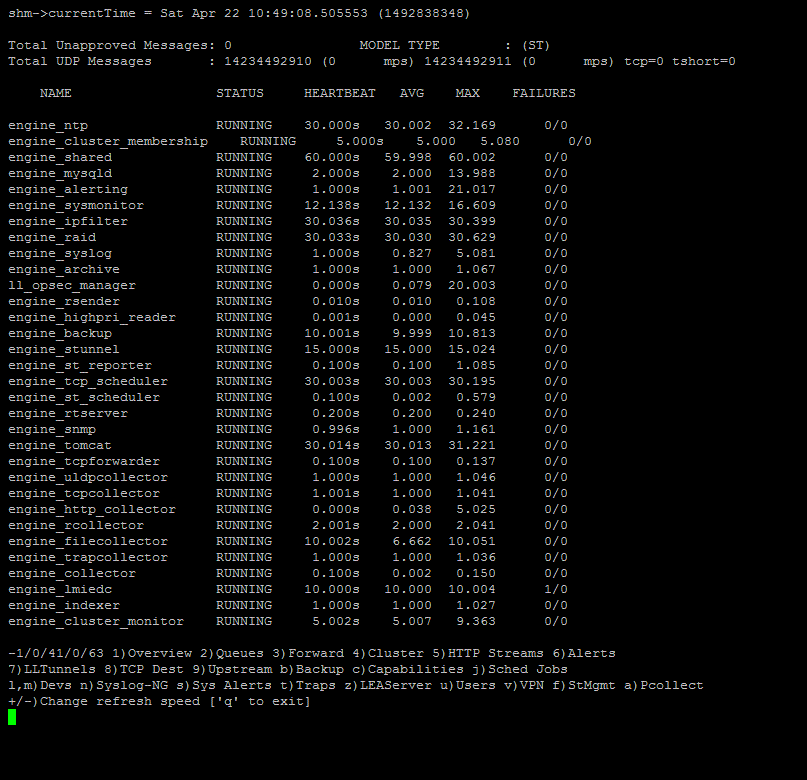

Anyhow, as per mcapra suspecting on right side of the issue. watchqueue command is to collect online application stats. Its executed in its own shell continuously. With appending option of page number i.e. 1 in our case it will generate a sanp of page in txt format as /tmp/watchqueue_1.txt. Hence <Path to commad>/watchqueue is command and 1 is the first page number to be printed.
Attaching sample output for
1) strace /usr/local/nagios/libexec/check_watchque (filename: strace without nrpe.txt)
(11.59 KiB) Downloaded 486 times
2) watchqueue command output (Filename: watchqueue command output.gif)
3) cat /tmp/watchqueue_1.txt (Filename: watchqueue_1)
watchqueue_1.txt
(2.63 KiB) Downloaded 472 times

Still suggested sudo config is on, this is the difference while running from cli and nagio UI
CLI command from nagios server:
[nagios@Nagiosserver ~]$ /usr/local/nagios/libexec/check_by_ssh -z -E  -H <remote server IP> -C /usr/local/nagios/libexec/check_watchque
Ok: Message rate is 13 | 13

Re: Unable to execute a application specific cmd using check
The only thing I can think of is that the watchqueue command that generates the /tmp/watchqueue_1.txt file is locking the file or it did not finish writing the timestamp and that is causing the error.
Can you verify that the script is getting the current time and the timestamp out of the file by adding the following lines to the /usr/local/nagios/libexec/check_watchque script?
echo "$EPOC1" >>/tmp/time
echo "$EPOC2" >>/tmp/time
Then run the check and see what is in the /tmp/time file for those 2 variables.
