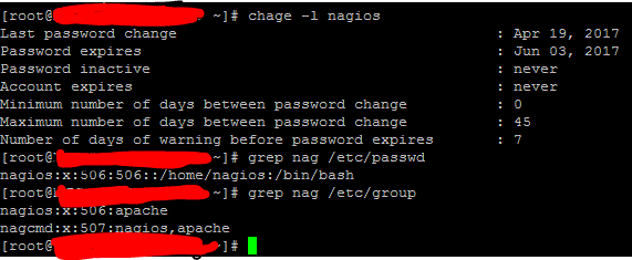

Also, can you run the following commands on your remote server and post the output?
change -l nagios
grep nag /etc/passwd
grep nag /etc/group

@tgriep :
Same result, no success for below attempt:
nagios ALL=NOPASSWD: /usr/local/nagios/libexec/check_watchque
as per your required output:
users details.GIF (11.04 KiB) Viewed 6382 times
