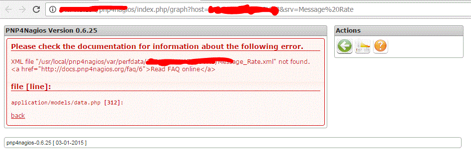

I start getting below snapshot on nagios UI and CLI
[nagios@nagiosserver~]$ /usr/local/nagios/libexec/check_by_ssh -v -z -E -S -H <Remote server IP> -C /usr/local/nagios/libexec/check_watchque
Command: /usr/bin/ssh
Argument 1: -tt
Argument 2: (remote server ip)
Argument 3: /usr/local/nagios/libexec/check_watchque
OK - check_by_ssh: Remote command '/usr/local/nagios/libexec/check_watchque' returned status 0
Any further suggestions on this characters, this may be leading to not plot graph details.

Can you please help me to understand why performance data is not processing?
