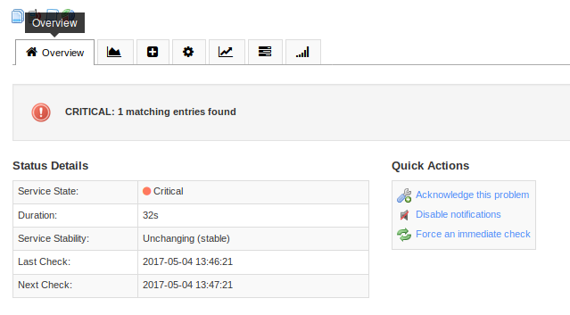

I just test the NRDP integration with Nagios Log and Nagios XI. It's working fine but I don't see any detail information in the alert status.
I want the message instead of the matching message. It's possible ?
I also need the possiblity to add the URL somewhere in Nagios to be able to see the detail by Nagios Log Server.
It's possible ?
Thank you in advance!!!

Being able to view the logs is a feature request already. It's task 5843 if you ever want to check on the status.
As far as adding the URL in XI, you could do this with a Custom Dashlet. It might not be the best place for it, but most of the PHP files are not protected by source guardian, so you could try adding the link on your test XI server (as a reminder, each license gives you the opportunity to install one XI for production, one for testing, and one as a backup).
It's not 100% clear to me if you want both the link and the logs or if one or the other would work. If you'd like both to be an option, I will be happy to put in a feature request for a link to the log server.
You could put the URL in a note, but I don't know that that's any more useful that having the address there in the CCM, but maybe it's one less click.

Can you give the link for task 5843 please.
That shortcut is for our Operation center team. He have to handle a lot of alert and quicker the step are better the result is for us.
The better option is to get the log message as alert status message.

bennyboy wrote: Can you give the link for task 5843 please.
I could give you a link, but it wouldn't do you any good as the feature requests are only internal.
I can tell you that the status changed from "Pending Approval" to "Unhandled" in March. There is not yet a release version listed on the task. We can just leave this thread open and you can check back after XI 5.5 is out and see if it was added. Unfortunately, I can't give you a date yet for XI 5.5. I think Sept 1 is a pretty safe day to check back if you haven't seen XI 5.5 before then, but again, Sept 1 is not a guarantee.
