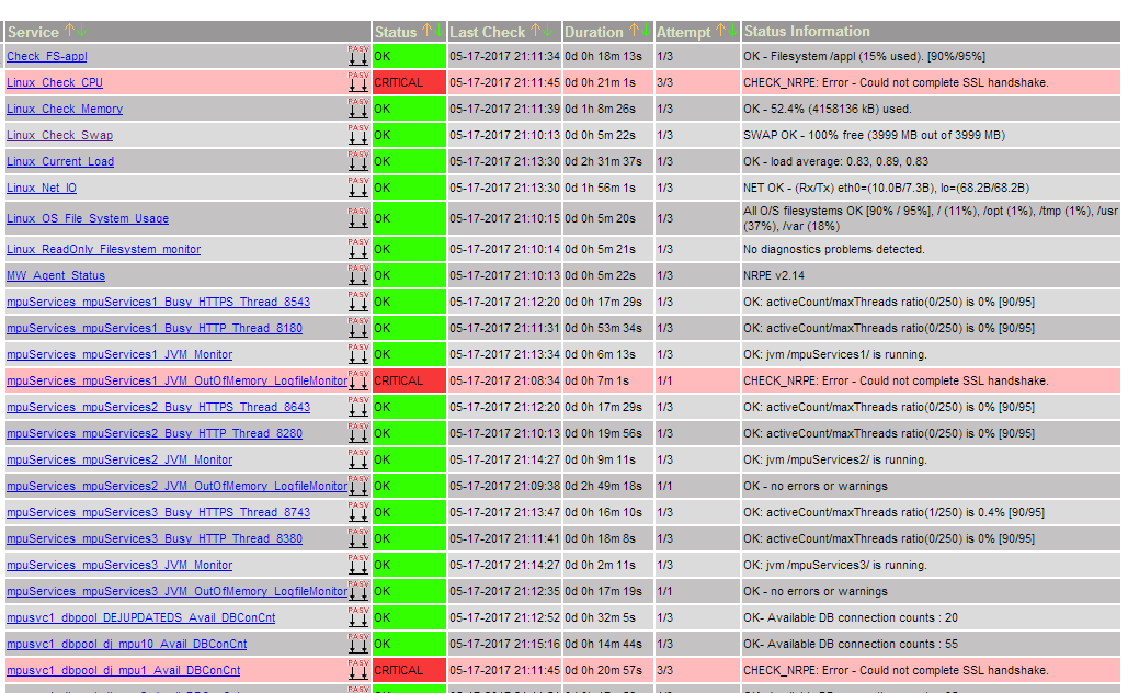

As shown in attachment, Nagios is throwing "CHECK_NRPE: Error - Could not complete SSL handshake" for some specific monitors not for all. If i execute the command from Nagios Core server, It is not throwing error.
-bash-4.1$ /usr/local/nagios/libexec/check_nrpe -H XXXXX.YYYYY.com -p 5665 -c check_swap
SWAP OK - 100% free (3999 MB out of 3999 MB) |swap=3999MB;0;0;0;3999
-bash-4.1$
This is momentary issue,If one service is throwing this error, After some time this monitor will be in OK state and some other monitor will throw this error. It is generating lot of false alerts.

You could increase the time between checks if it is switching on and off. Are the hosts going up and down as well? It sounds to me like a network issue.mdhinesh wrote:It is generating lot of false alerts.
Also, do you have anything set up to automatically restart services? Maybe it's failing completely and then being turned back on.
Is the NRPE version the same on working checks versus non-working checks?
