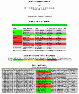

Although running this test for a single host for this discussion, the data also appears incorrect for hostgroups that contain this and other hosts. Same thing for some services. I picked a single host that I know was down for some short periods of time in order to verify it should not be %100. It was not "scheduled down", it was just down, which for purposes of this discussion is a good thing. In running a report for a single host, here are my findings.....
1. Availability for a single host, all defaults, Last 7 days. Report Time period None, yes, yes, yes, no, First Assumed Host State (Host Up),First Assumed Service State: (Service OK)
  • looks fine, except why would "Host Log Entries:" include items from 2015 through 2017? weird because it's not in the Time period specified by the report. (no, I did not click "View full log entries")
2. Same thing, except changed Time Period to "This Year"
  • ok, now I get something other than %100 which is what we want and expect. Up is 99.508% (137d 16h 51m 54s) Down is .492% (0d 16h 19m 42s) The Host Log Entries outside of the report period persists, but include the January and early April down time---- take note.

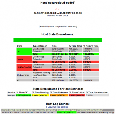

3. Changed time period to "Custom" . 5-1-2016 to 4-30-2017
  • Here's the problem- Up 100%, Down 0%, Nothing in host log entries
My questions are:
So if we know the host was down in January and early April of this year (see #2), and that time range is included in the Custom Report time range, why does the report show uptime of 100%, and also not show the host log entries like it did before.

Report for April 30 2016 through May 1 2017 - should include data from "This year" - not correct..
Report for "This year" - looks correct
