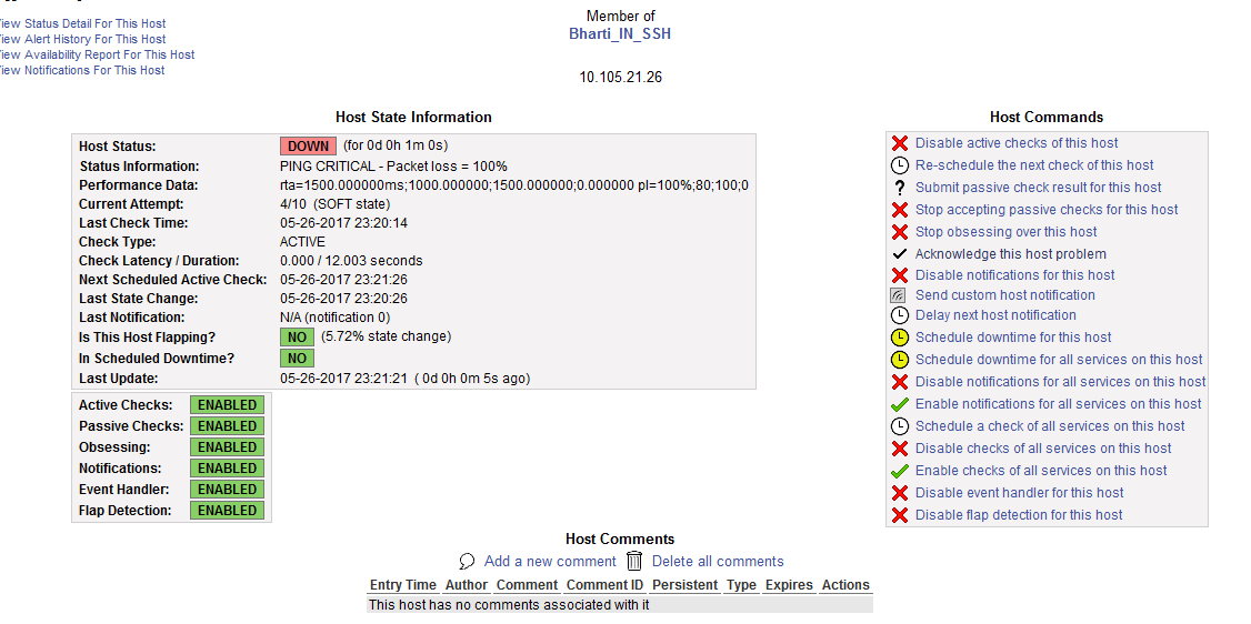

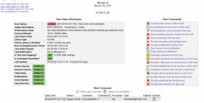

Attached are the screenshot for the steps i followed :
let me know if i need to add something in configuration file
step 3 : After service restart
step 2 : after acknowlegment
step 1 acknowledged
step 1 acknowledged
