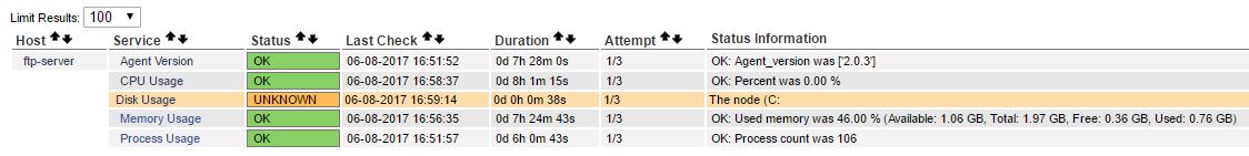

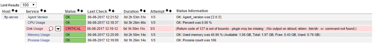

Now I have another question about check command syntax.
As you can see in the attached screen capture probably there's something wrong in the definition service I wrote in Nagios Config file:
host_name ftp-server
service_description Disk Usage
check_command check_ncpa!-t 'mytoken' -P 5693 -M disk/logical/C:| -w 80 -c 90
My goal is to monitor all disk partitions and send an alert message when 80% of disk usage is reached or a critical alert when 90% of disk usage is reached.
Thank you for your patient!
Re: Nagios and NCPA
I am glad I could help, cerino! For the second problem, try changing this:
to this:define service{
Let me know if this helped.define service{
check_command check_ncpa!-t 'mytoken' -P 5693 -M 'disk/logical/C:|/used_percent' -w 80 -c 90
Re: Nagios and NCPA
Can you run the following commands from the command line on the Nagios server, and show the output?
Also, show us the service definition of the "Disk Usage" service on the "ftp-server" host. Thanks!
/usr/local/nagios/libexec/check_ncpa.py -H 10.1.3.4 -P 5693 -t mytoken -M 'disk/logical/C:|/used_percent' -w 80 -c 90
/usr/local/nagios/libexec/check_ncpa.py -H 10.1.3.4 -P 5693 -t mytoken -M 'disk/logical/C:|/used_percent' -w 80 -c 90 -vvvBe sure to check out our Knowledgebase for helpful articles and solutions!
