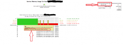

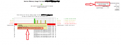

4. I have changed "First assumed service state = Service OK" - here it shows "OK" but is says as "Fake Log Entry" and even tested it by setting "First assumed service state = Service CRITICAL" it shows as "CRITICAL" saying "Fake Log Entry".
Below i am attaching the Screen shots of Nagios Logs, Status of Trends after setting the "Service as OK" and "Service as CRITICAL".
Thank You!!
Status of "Service as CRITICAL"
Status of "Service as OK"

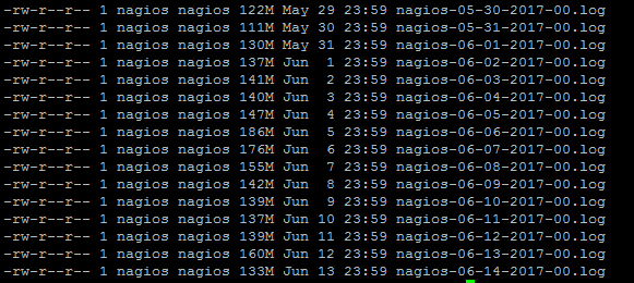

Nagios logs from my Ubuntu server

And for the log file of (28th May) which you have asked,FYI i have log files form (30th of May).As the server is hosted in AWS i keep only 15 Days of logs in order to eliminate the Storage issues.
In the Log file of 30th May on Top it says :-
LOG ROTATION :- DAILY
LOG VERSION :- 2.0
Thank You!!

When the trend report runs, it looks at the log files in the archives folder to gather the data to display in the Trends graph.
If the files are pruned off and only 15 days are present, then you will only be able to show the last 15 days in the Trends graph.
There is not a separate file that stores the history so it you want to view the Trends for a longer period, you will have to keep the archived log files on the system for that period of time.
