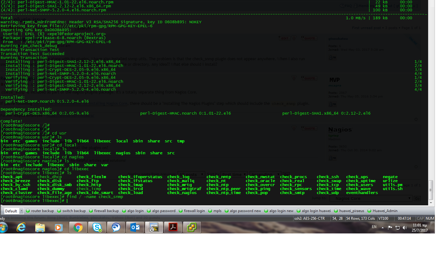

i have installed Nagios Core along with its plugins. I have also installed snmp utils. The problem is that the check_snmp plugin does not appear anywhere. When i also run snmpwalk command, i get the error -bash: ./check_snmp: No such file or directory. Any idea?? What else should i install?

the OS is Centos 6.7. I have followed the steps for installing net-snmp lib. I have also attached the following file. Any other idea?
Re: Snmp plugin issue
Make sure the following packages net-snmp packages are installed on the server.
net-snmp net-snmp-devel net-snmp-libs net-snmp-perl net-snmp-utils
If they are not, run the following to install them.
yum install net-snmp net-snmp-devel net-snmp-libs net-snmp-perl net-snmp-utils -y
Then recompile the plugins to see if the check_snmp plugin is built.
Make sure you run a
make clean
first then re-run the configure script before recompiling.
If it still doesn't compile, in the folder where you compiled the plugins, there should be a config.log file.
Can you post it here?
