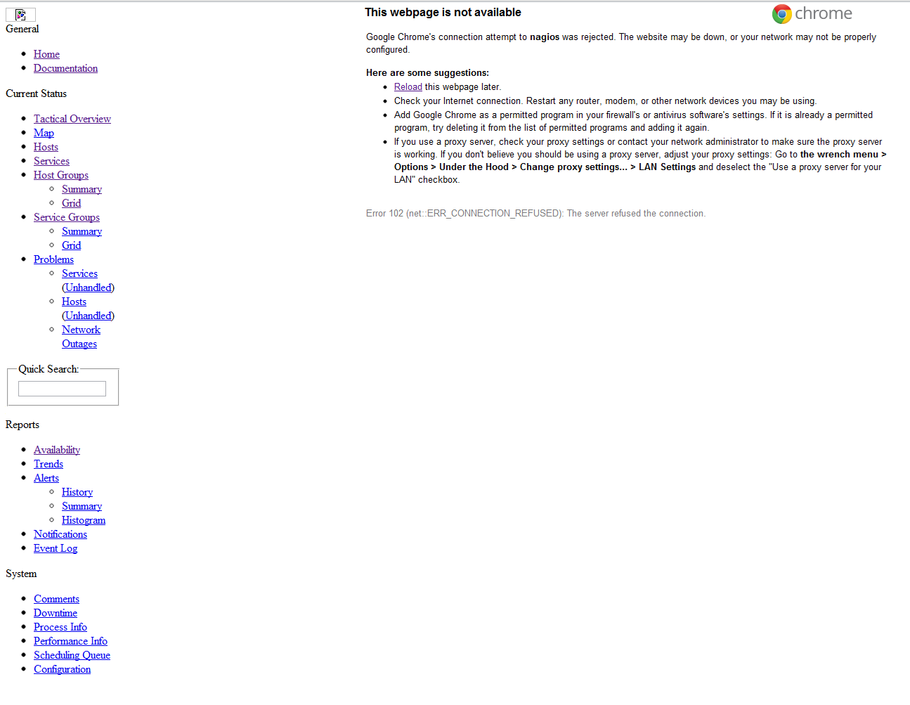

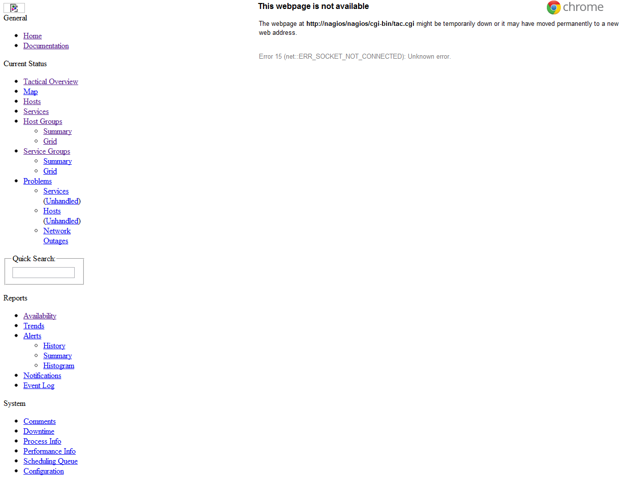

After a couple of minutes I am able to log in and navigate without issue. After a few minutes the page will auto-refresh and I see the page attached (nagios_err).
Error 15 (net:ERR_SOCKET_NOT_CONNECTED): Unknown Error. This is a virtual machine sitting on ESX host. After a few minutes I'll be able to refresh page and it will attempt to load but fail with connection refused (see attached). It's very frustrating.

Connection to Nagios was interrupted with Error 101 (net:ERR_CONNECTION_RESET) The connection was reset.
