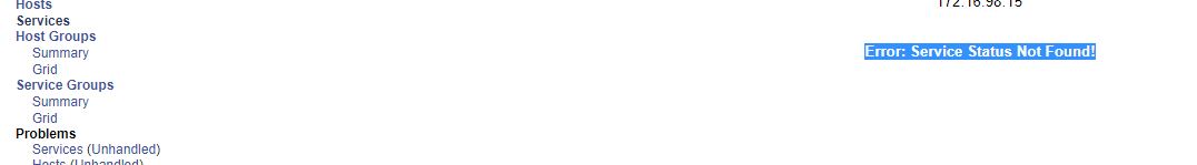

Hi All ,
While i am trying to Re-schedule the next check of any servers i am getting an error stating "Error: Service Status Not Found!" please find the attachement of screenshot as well.
This issue i am facing frequently

Re: Nagios Core UI Issue
In the output of the ps command, it shows that there are multiple copies of the Nagios processes running and that would cause the issue you are seeing.
To fix this, login as root to the Nagios server and run the following commands.
service nagios stop
killall -9 nagios
service nagios start
Give the system 10 minutes to run and see if you can reschedule the checks.
