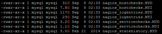

When i check database tables in "/var/lib/mysql/nagios" the "nagios_logentries.MYD" is taking 117GB, attaching the screen shot of files that taking more space and Does this making it freeze frequently and its happening more often when we add anything new to cfg files and do "Service nagios reload" than Restart.
Nagios DB Tables.PNG (11.08 KiB) Viewed 7751 times

If you do not need all of the logentries data from the MYSQL database, you can truncate it and optimize that table to shrink it, it that an option?
Basically the MYSQL logentries table is the same data that is in the nagios.log file and the archived log files. If you are not using the MYSQL database, you can truncate it.
