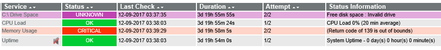

I am trying to monitor the Windows 2012 host using the Nagios Core.
I have installed the NSClient on the Server.
For the Drive Space i am getting the Error Invalid Drive.
For Memory usage i am getting the Error " Return code of 139 is out of Bounds"
It seems that it is not able to fetch other data as well, please have a look at the screenshot attached.

Following Error:
For C Drive--- Invalid Drive
For Memory usage--- Return code of 139 is out of bounds
UP time --- it is showing 0 days but server is up since long time
Port 12489 has been unblocked.
out of the 2 servers, i am able to get connected to the one server.
For 1 server i am still not able to get the data.
Following Error:
