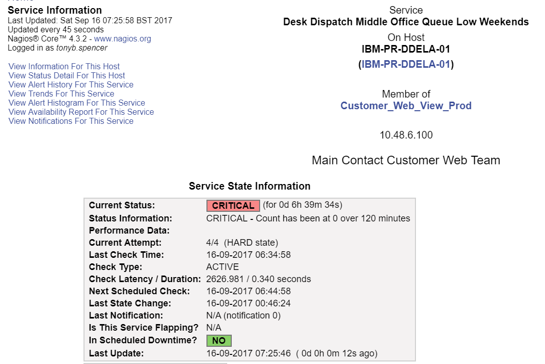

I am seeing some high check latency and can't work out what is causing it.

The process queue is about 30 minutes behind the current time.

Have now upgraded to 4.3.4 and the issue seems to still remain.
I reload Nagios and the scheduling queue displays the next check time as the current time but then falls behind again.
Latency on checks are around 40 minutes still.
