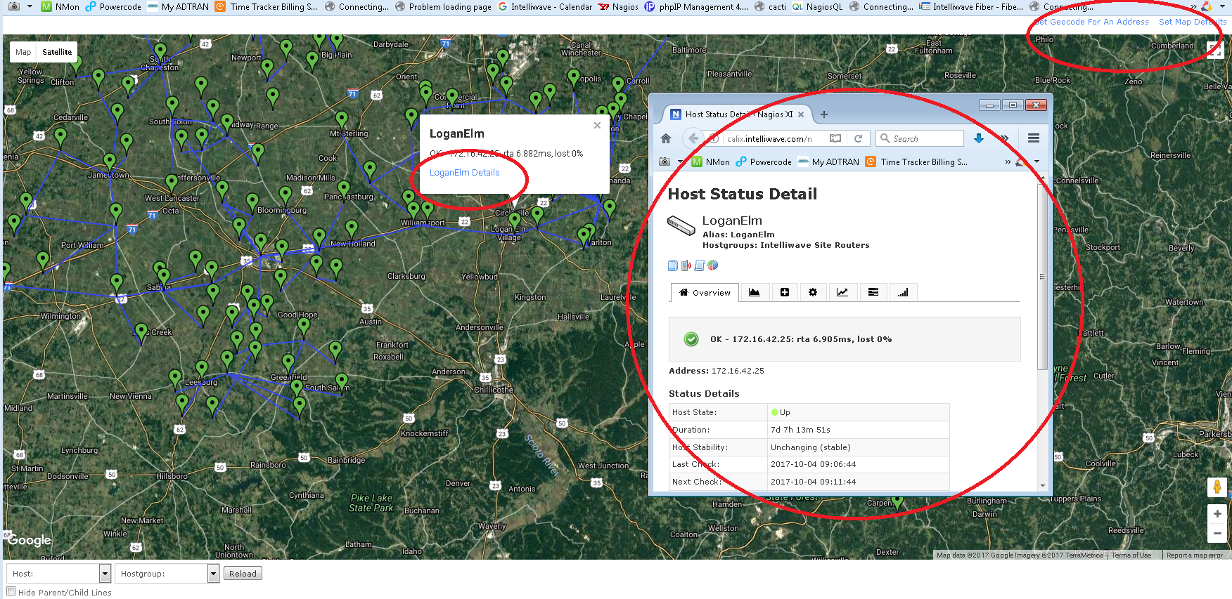

Sorry Not google earth (google maps) and plugin is up to date, here is the screen shot,i circled in red items i would like to be able to remove I just would like to know if it is possible to remove
the clickable links and access to the Host Status details.... Basically would like the option to just show good status and bad status only with ability to zoom it, no extended information on the pop-out...
thanks,

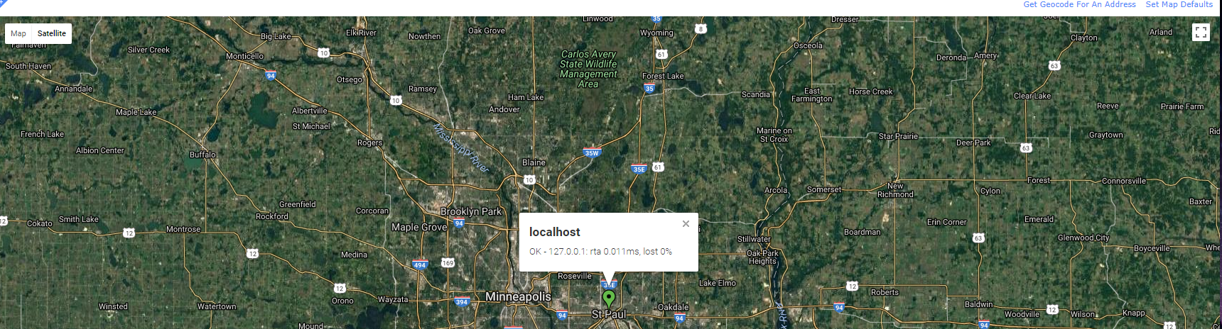

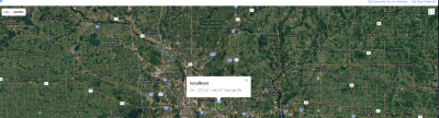

Here's my example of when I removed those lines in the buildmarkers PHP file.
