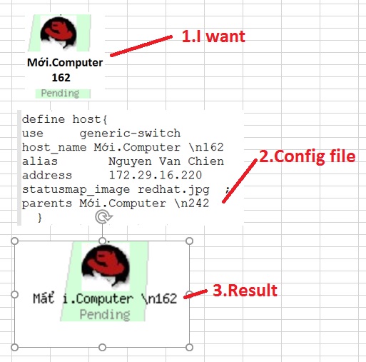

I used Nagios Core 4.0.4 and really like the map, but i want to use host name with some name like this: "Chiến" or "Mới"...but after create png map the hostname display wrong font.
And, sometime i need hostname length > 20 characters -> result on map(Balance Tree): the name overlap -> can i display name with two lines?
Thanks you !
$Hostname$ not support unicode

Can you attach a screenshot of where you are seeing that the name is incorrect?
Does Nagios work otherwise with those hostnames? I know for a fact 4.2.4 and newer will work with those hostnames, but there are a bunch of different maps, so I want to be sure I am looking at the same thing.
Also, are the two issues on the same map? If not, can you split this into two threads?

Thanks for your reply,
Please check the attached picture for details.

@Chien_San, Unfortunately, it's impossible split the hostname over two lines. Special characters are not supported as of right now. And all the configs for the Nagios map reside in precompiled cgi files.
