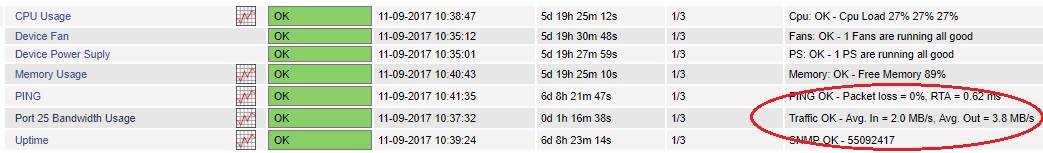

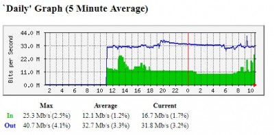

hello people, I have a problem that I can not solve because I ask for help from this kind community.
I want to monitor a port of a cisco switch, I'm using mrtg, I generate the .log file and I get to see the graph and the consumption correctly (Out 40.7 Mb / s (4.1%), In 25.3 Mb / s (2.5%)), The port in question is fiber optic with a speed of 1GB, therefore that is the limit.
But when the file.cfg that corresponds to the host, I use the command:
check_command check_local_mrtgtraf! /var/www/mrtg/172.16.100.190_gigabitethernet1_0_25.log! AVG! 500000000,600000000! 900000000,1000000000! 10
On the Nagios graph and also using the pnp4nagios plugin, it shows me the wrong data, (Traffic OK - Avg. In = 2.0 MB / s, Avg. Out = 3.8 MB / s)
I was researching a lot, and maybe I saw some plugin use bits and other bytes. But I do not know why in one place the graph and consumption are good and in another place it is different.
I do the test with the dude, and it's equivalent to the graph that I attached to nagios2-mrtg, so it's apparently correct that configuration.
I hope you can help me. Greetings from Argentina

Currently, I am using
check_mrtgtraf v2.2.1 (nagios-plugins 2.2.1)
This is the config of my host:
use generic-service,srv-pnp
host_name sw-01
service_description Port 25 Bandwidth Usage
check_command check_local_mrtgtraf!/var/www/mrtg/172.16.100.190_gigabitethernet1_0_25.log!AVG!5000000,6000000!9000000,10000000!10
I need to be able to visualize the bandwidth of a network interface, the equipment is a cisco catalyst 2960 switch. Or maybe configure to show the option in real megaytes, I do not know why it shows so little in The Dude shows much more, or in the same mrtg it looks good. If there is another tool that I would like to recommend, but until now everything that probe did not work
host_name sw-01

I was researching more, and I could do something, in the host configuration file /etc/mrtg/switch1.cfg in the options section I was changing values:
Originally had:
# to get bits instead of bytes and graphs growing to the right
#Options [_]: growright, bits
And I change it for this:
Options [_]: growright, nopercent, gauge
As a result of the graphics that it shows me through the web interface, it gives me the same result that I see on the nagios website. I think it's a format issue in Nagios but I can not imagine where it can be, in the case of mrtg I know where it is, and leaving the bits option shows me the real value in megabytes as attach to the screenshots, any suggestions?
Originally had:

This is the page of nagios, my problem is that the visualization but in a different format, I am using version 4.3.4 of Nagios Core. The ip correponde to switch sw-01, I leave the command and the service, the commands I have in the file commands.cfg in the directory objets where most are working well.

kyang
Re: Problems to see the bandwidth correctly with mrtg
Is this the script you want to create a service check for?I'm using a script check_snmp_int_v3, I made it work but I do not know how to create a command and service, do they give me a hand?
./check_snmp_int.pl -v2c -H 172.16.100.190 -C public -n GigabitEthernet1/0/25 -k -BM -w 200000,400000 -c 600000,900000
Did you define the command in your commands.cfg?
From how you ran the script you have something like this.
-v2c -H $HOSTADDRESS$ -C $ARG1$ -n $ARG2$ -k -BM -w $ARG3$ -c $ARG4$
# 'check_snmp_int.pl' command definition
command_name check_snmp_int.pl
command_line $USER1$/check_snmp_int.pl -v2c -H $HOSTADDRESS$ -C $ARG1$ -n $ARG2$ -k -BM -w $ARG3$ -c $ARG4$
}Either way, test it out and let us know.
