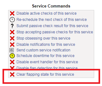

Right now, Nagios is saying a service is flapping (it really isnt, I was testing stuff and now it is is set to the status it is suppose to be)
How do I remove it (or in order words reset "Is this service flapping?" to no)?

Here's the original GitHub issue for this functionality:
https://github.com/NagiosEnterprises/na ... issues/142
Which version of Nagios Core are you using? This functionality appears to have been included as of 4.3.0:
kyang
Re: Clear "flapping" state?
Post by kyang »
Thank for the help @mcapra!
