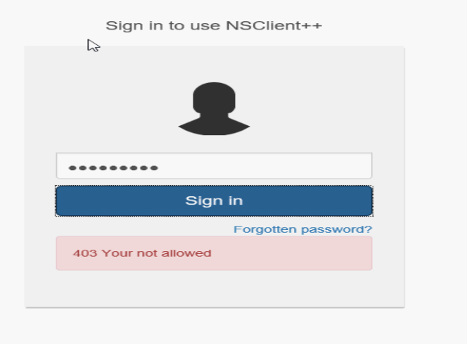

I have install NSCLIENT++ on windows operating system. When I tried to access it. I got password error. see below.
Even I have set the password during the installation of nsclient++ and also I have set the password on commnad.cfg. Still I am unable to access the page.
Getting error on NSCLIENT++

Which version of NSClient++ are you using? Did you follow any specific documentation when configuring NSClient++?
You might have better luck on the NSClient++ forums. No one here is directly involved with the development of NSClient++.
Here's the official documentation for the NSClient++ WEBServer module:
https://docs.nsclient.org/reference/generic/WEBServer/
I believe this section contains the answer you need:
https://docs.nsclient.org/reference/gen ... password_1
Looking under the hood of this module, it looks like you should also be able to retrieve the password via the CLI:
https://github.com/mickem/nscp/blob/61a ... #L545-L546
Following the usage instructions I also found in there:
Something like this executed from the CLI *might* work against the latest NSClient++ version, but I don't have one to test against:

I have replaced the client software. Now I am using NCPA. It is working fine now. thanks
