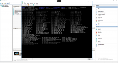

Ok I figured out that one on my own as well. The htpasswd.users and cgi.cfg files were moved and not in the /usr/local/nagios/etc/ directory. The last part preventing me from proceeding with testing is that I have no hosts or services listed, even though I copied my existing configuration from our production server to the test one. They are currently in the following directories on the test VM:
Root folder: /usr/local/nagios/etc/objects/
Hosts: /usr/local/nagios/etc/objects/hosts/
Services: /usr/local/nagios/etc/objects/services
I attached screenshots of what I see in the web interface and how the directory structure looks on my test server. I renamed some of the files that came with the 4.4.1 installation to .default so I can use my existing files instead for the new server.
Please let me know if there are conflicts in the files, in the wrong directories or if I didn't perform the step process correctly. I would like to have the web interface reflect the current hosts and service checks we have in place so I can test receiving an output from service check and notifications. Thanks!

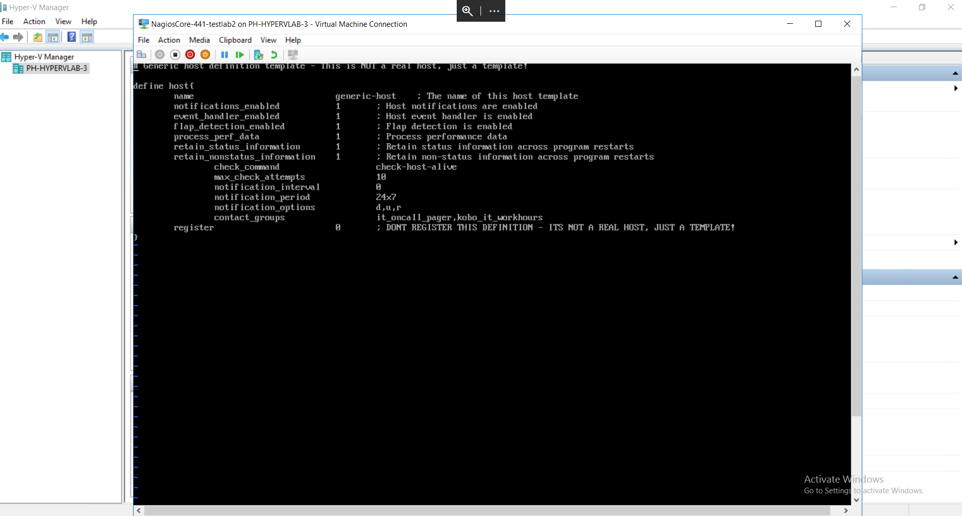

Yes, I understand what your saying. However, all the same configuration is working on my production server. Something must have been changed recently when moving around files to correct errors. I have attached 4 files: host template, service template, hostgroups, and nagios.cfg file.
I have edited the nagios.cfg file to point to the directories containing my config files. Nothing has changed so i'm confused as to why those host files are complaining about not seeing the max_attempts value when they are in the templates associated.
I will continue looking around but spent a almost 2 days and i'm hoping you can help figure this out so I can continue testing and replace this working server with our existing one.
