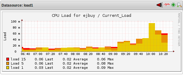

I have configured pnp4nagios graph with nagios core in centos 7, so issue is graph is not showing proper like in server currant load graph it showing 20m,40m can any on have idea about this issue?
hear I attached currant load graph screen shot.

Can we see the output of the plugin that is being used to generate this graph also?

Re: pnp4nagios graph not generate proper with nagios core 4.
It could be that there is a template that is modifying the performance data output and changing the graph.
We would need to see how the check is defined in Nagios to figure out the name of the template, so can you post that service's configuration?
Can you run the following and post the output so we can see what the
You may have to adjust the command to fit your environment.
Then, take a look at the check_load PNP template to see if it is changing the way the graph is being built.
The default location is typically here.
Below is the default settings in the template.
./check_nrpe -H localqa -c check_load -w 7.0,6.0,5.0 -c 10.0,9.0,8.0Then, take a look at the check_load PNP template to see if it is changing the way the graph is being built.
/usr/local/pnp4nagios/share/templates.dist/check_load.phpCode: Select all
Sorry, I missed the -a option for the check_nrpe command from my example.
But the plugin's performance data output looks correct so the PHP4Nagios template will have to be checked to see if it changing the way the graph is generated.
Search the Nagios system for this file and post it here.

$def[1] = rrd::def("var1", $RRDFILE[1], $DS[1], "AVERAGE");
$def[1] .= rrd::def("var2", $RRDFILE[2], $DS[2], "AVERAGE");
$def[1] .= rrd::def("var3", $RRDFILE[3], $DS[3], "AVERAGE");
if ($WARN[1] != "") {
$def[1] .= "HRULE:$WARN[1]#FFFF00 ";
if ($CRIT[1] != "") {
$def[1] .= "HRULE:$CRIT[1]#FF0000 ";
$def[1] .= rrd::area("var3", "#ff0000", "load 15") ;
$def[1] .= rrd::gprint("var3", array("LAST", "AVERAGE", "MAX"), "%6.2lf");
$def[1] .= rrd::area("var2", "#EA8F00", "Load 5 ") ;
$def[1] .= rrd::gprint("var2", array("LAST", "AVERAGE", "MAX"), "%6.2lf");
$def[1] .= rrd::area("var1", "#EACC00", "load 1 ") ;
$def[1] .= rrd::gprint("var1", array("LAST", "AVERAGE", "MAX"), "%6.2lf");
sysadmin@Sysadmin:~$
The template looks standard so that should not be causing the issue but you may want to check the php4nagios website and see if there are and configs or special templates causing the graph to display differently.
https://docs.pnp4nagios.org/pnp-0.6/start
One thing to try is to delete the .rrd and .xml files for that service and see if they get recreated correctly.
