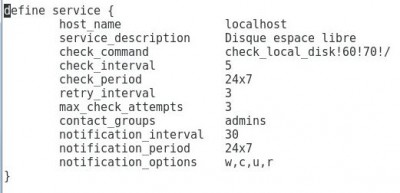

Here my config file of the service :

Your execution from the CLI contains a percentage, but your service definition only contains an integer. check_disk supports both percent and integer values and has different behaviors depending on what you pass it:
If you want to be alerted when the disk availability falls below a certain percentage, I would recommend including a percentage value passed to the warning/critical args in your service definition.
-w, --warning=INTEGER
Exit with WARNING status if less than INTEGER units of disk are free
-w, --warning=PERCENT%
Exit with WARNING status if less than PERCENT of disk space is free
-c, --critical=INTEGER
Exit with CRITICAL status if less than INTEGER units of disk are free
-c, --critical=PERCENT%
Exit with CRITICAL status if less than PERCENT of disk space is freeFormer Nagios employee

Yes !! It's this, thanks a lot mcapra
