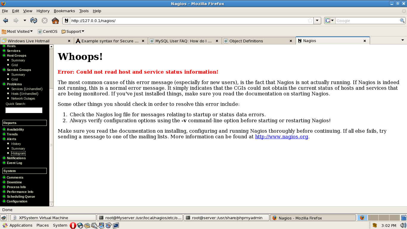

I am new to nagios and now not able to access any information.
please find the attachment for the problem on all the links i got the same error,
and in log file i got this

help me
Not able to start NAGIOS
- problem.png (140.72 KiB) Viewed 3163 times
Re: Not able to start NAGIOS
I think the usual cause of the first problem is that the permissions on the plugin do not permit the nagios user to run it. The problem shown on your screenshot usually indicates that the nagios daemon is not running.
