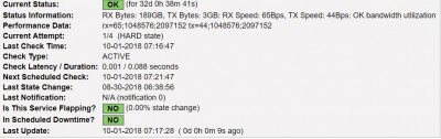

i have installed uniqush https://github.com/uniqush/uniqush-push on my centos server where i am using nrpe plugins check_eth https://exchange.nagios.org/directory/P ... th/details to monitor bandwidth usage of my uniqush server. It shows 189GB RX byte which is too much if i compare to rest of my server where also nrpe plugins check_eth is installed. Can anyone please help me why it is showing too much RX byte?

I'm not familiar with this plugin but this looks like the total bytes transmitted by the interface.
Looking at the plugin it parses the following command, can you run it on this server and post the output
cat /proc/net/dev
