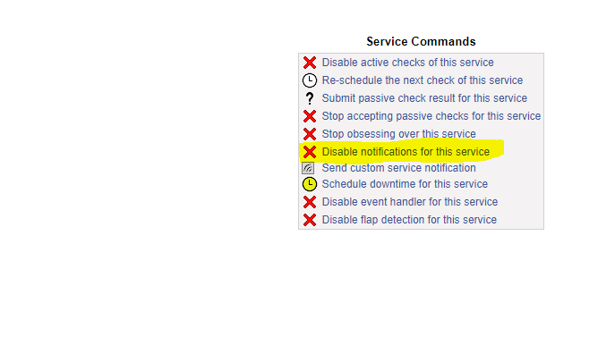

Hi
I want to change service commands that are available through Nagios GUI.
I want to remove the highlighted one in the attached screenshot.
I have searched but I am unable to find anything about this.
Does anybody know hoe to do this.
Re: Remove a Service Command from GUI
This is written into the cgi's in nagios, the only way to remove them would be to remove them from the source and recompile the modified source
https://github.com/NagiosEnterprises/nagioscore
the specific lines you are looking for are in this file
https://github.com/NagiosEnterprises/na ... tatuswml.c
