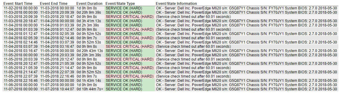

Postby parweez » Wed Nov 07, 2018 1:13 pm
I am seeing this error on 2 out of 6 of my hosts which are dell poweredge m620s. Does anyone have a clue on to why this is happening?

@parweez, Is this an snmp based check? These timeouts could indicate either a very slow response from the server or some kind of networking issue. I'd start by increasing the timeout value for this check from 60 to 120 seconds and see if the errors go away. You'd also need to increase the timeout in the /usr/local/nagios/etc/nagios.cfg.

Postby parweez » Thu Nov 08, 2018 9:49 am
It is using snmp. If it's a network issue how come the plugin works most of the time but doesn't work in very small intervals?

Postby npolovenko » Thu Nov 08, 2018 11:28 am
@parweez, Sometimes flooded network causes issues where communication between two servers will come in and out. Or the monitored server might be getting overloaded and stops responding to SNMP queries. I'd try to turn on the SNMP debugging on your Dell server and look for any errors.
