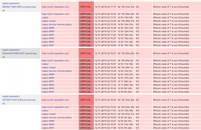

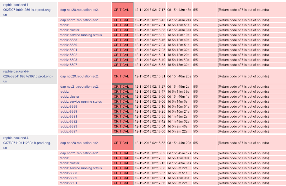

with nagios/nagios4 user it results good in CLI. But proble with nagios UI. CommandLine resulting good but not UI resulting (Return code of 7 is out of bounds) . I am adding the screenshot of UI for your reference.

NagiosUI result
NagiosUI result

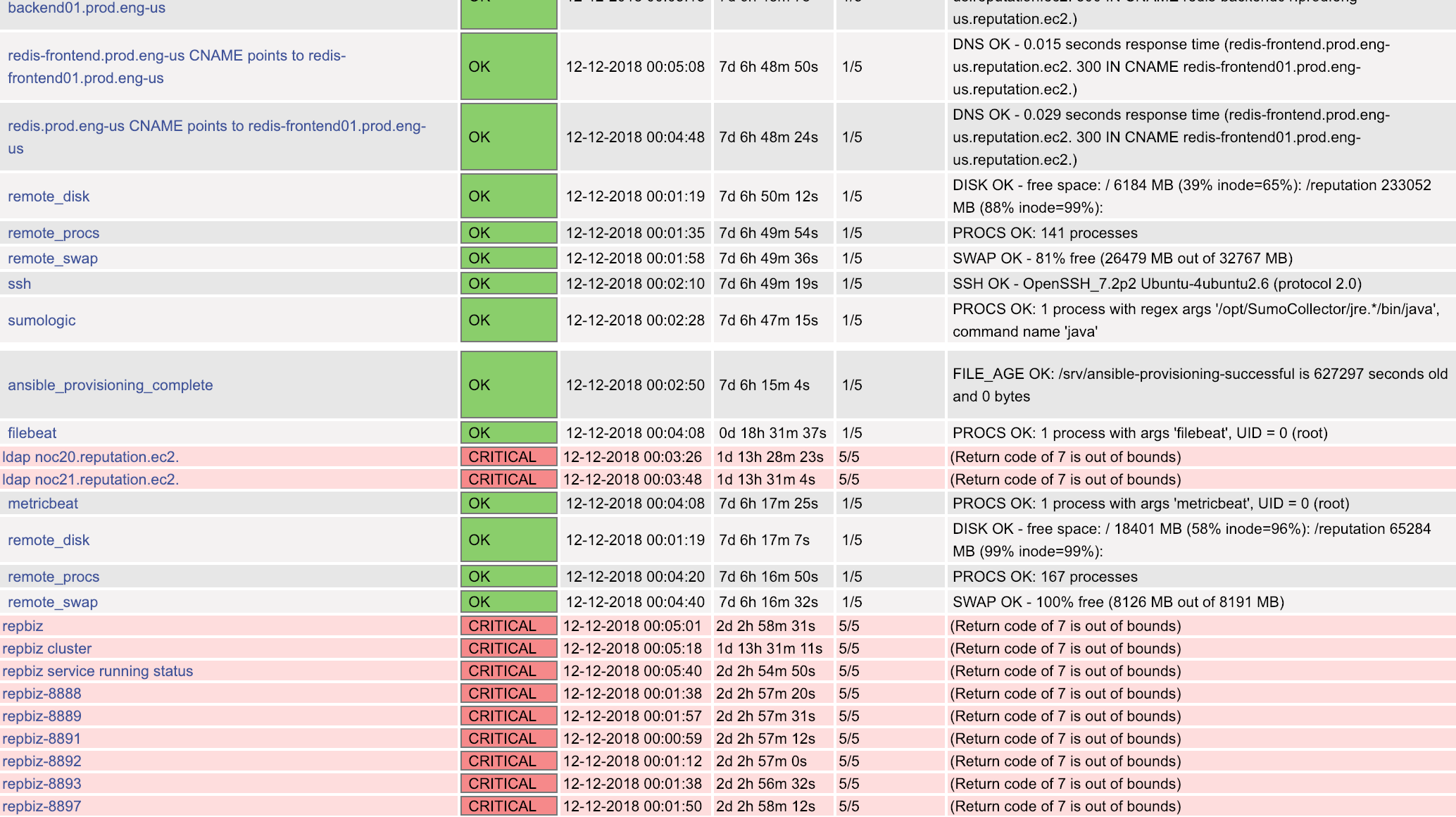

Atcching a screenshot for your reference:
