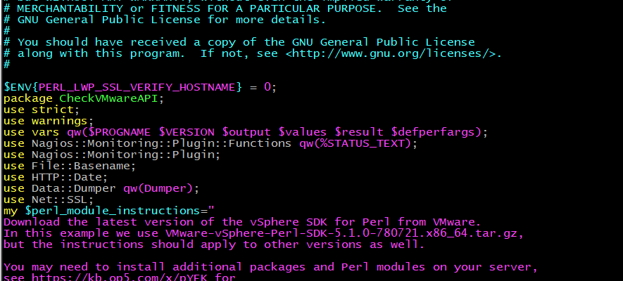

Some people reported issues with this plugin with unsigned certificates. I am not sure if this is the case here, but you could try an easy "workaround". Open the plugin in a text editor and add this as the first line (after the comments):
$ENV{PERL_LWP_SSL_VERIFY_HOSTNAME} = 0;
Save, exit, and try your check again.

4. I added $ENV{PERL_LWP_SSL_VERIFY_HOSTNAME} = 0;
check VMware api
root@tgcs017:/usr/local/nagios/libexec# ./check_vmware_api.pl -H myhost-2 -t 50 -u root -p "#########" -l runtime -s status -vvv
[extra-opts] check_vmware_api.pl -H myhost-2 -t 50 -u root -p ########### -l runtime -s status -vvv
CHECK_VMWARE_API.PL UNKNOWN - plugin timed out (timeout 50s)
Same results after adding the code.
