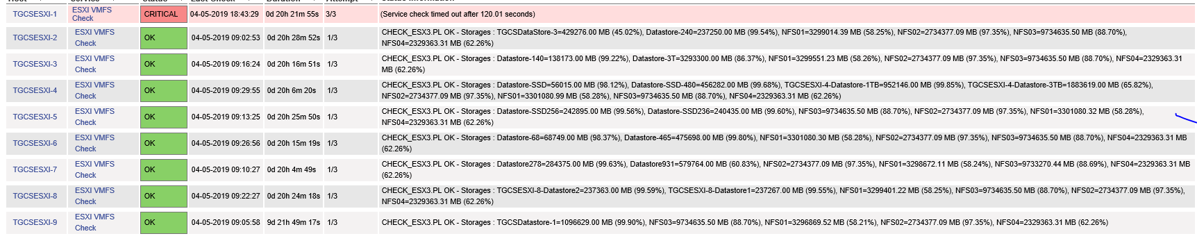

See image showing all esxi hosts working except for this one
showing all others
Any ideas?
