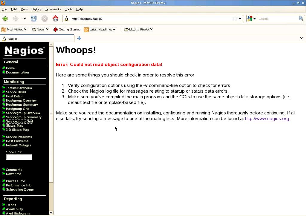

Hello;
there is strange error after installation on Nagios;
Whoops!
Error: Could not read object configuration data!
Here are some things you should check in order to resolve this error:
Verify configuration options using the -v command-line option to check for errors.
Check the Nagios log file for messages relating to startup or status data errors.
Make sure you read the documentation on installing, configuring and running Nagios thoroughly before continuing. If all else fails, try sending a message to one of the mailing lists. More information can be found at http://www.nagios.org.

there is no error on log file there no missing permission so where is my mistake??
any idea?

this is my problem :( i attached to post
