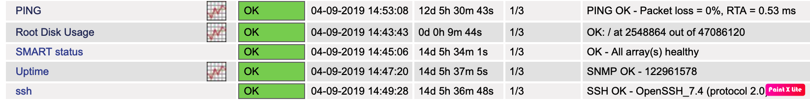

Thanks for the quick reply. Yes, the snmp_check_disk return me good service results, please see the screenshot attached. However it did not give me graph even though I have added -d option at the end of the command in host config file.

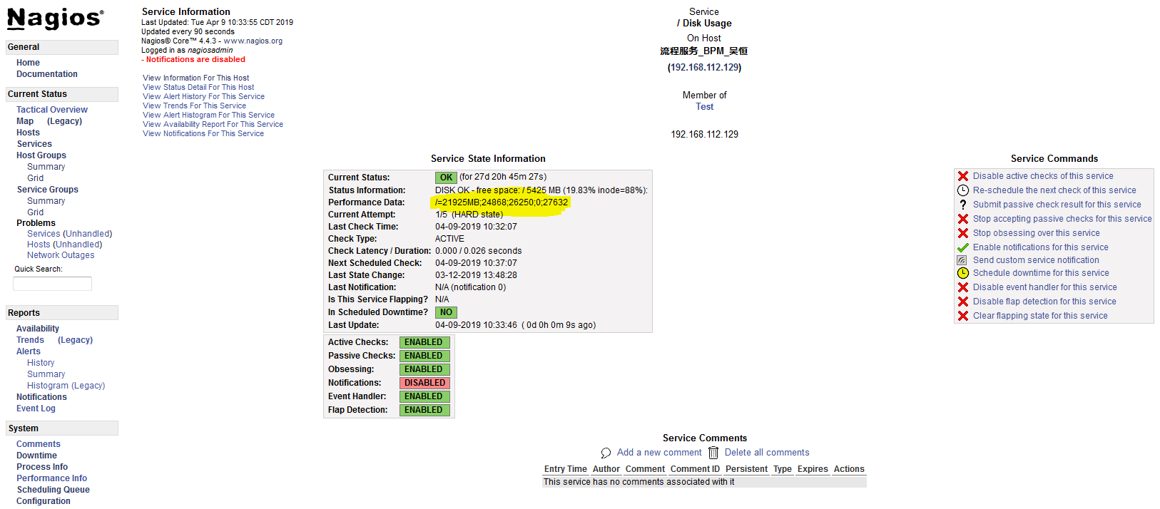

If you click on the Graph icon for the Root Disk Usage check, do you see the graph for the disk data?
The screen shot that you provided, did not show the performance data, go back there and click on the Root Disk Usage check and that should show you the details for that check as well as the performance data.
Attached is an example of that menu and the performance data is highlighted in yellow.

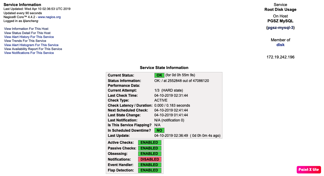

Hi, the check_snmp_disk return disk check information actually, please refer to another screenshot attached here. However, if I put -d in the command line, the service check would become unknown.
This gave me unknown result
# 'check_snmp_disk' command definition
        command_name    check_snmp_disk
        command_line    $USER1$/check_snmp_disk -d $ARG1$ abcdbeef $HOSTADDRESS$ $ARG2$ 70 90
This did not give me error but no rrd generated neither
        command_line    $USER1$/check_snmp_disk $ARG1$ abcdbeef $HOSTADDRESS$ $ARG2$ 70 90 -d
So I guess the plugin I used does not support pnp4nagios graph? Do you have another disk plugin that use snmp and can generate rrd for the disk usage? Thanks.

What you are looking for is a plugin that outputs performance data which, the pnp4nagios process will use to generate the graphs.
This plugin has a -f option that is used to output performance data. Give it a try.
