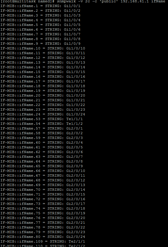

Out of curiosity what do you get when you run this against the IP address?
snmpwalk -v 2c -c 'public' XXX.XXX.XXX.XXX ifName
They may just be assigned different SNMP IDs

Thank you so much! You solved my problem.
