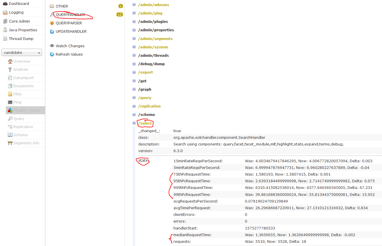

I am trying to monitoring our internal Solr system with Nagios, especially stats of cores (add screenshot).

I don't know much about Solr, but my understanding is the /select endpoint expects a query to be passed to it? And you're trying to monitor the response times of a particular query? Or are you trying to monitor stats for all /select calls that have been made over a period of time?

Thanks @mcapra!
As you say, endpoint expects a query to be passed to it. This is the issue.
Url (query): core:port/solr/#/vacancy/plugins?type=queryhandler&entry=%2Fselect
I check: https://github.com/alxgomz/nagios-plugi ... co_solr.py
I should to create a new function to check stats.
